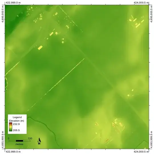

Consider the following example. Here is a detailed LiDAR DEM of a small area in a very flat landscape of undulating terrain.
The DEM contains off terrain objects (some may call it a digital surface model) and they are washing out the statistical distribution with a long upper tail. There is also a lower tail that is associated with a deeply entrenched channel. The result is that the DEM visualization is not particularly effective for applications where I want to relay information about the undulating topography.

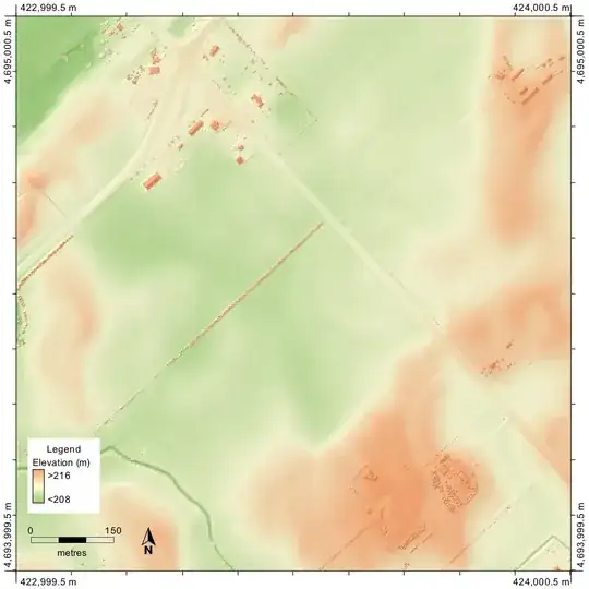

The actual terrain has a maximum elevation of about 216 m (i.e. the ~30 m of relief in the DEM is dominated by those off-terrain objects), so I scale the palette, choose an effective palette with plenty of meaningful colour changes (without white!) and transparently overlay a hillshade image:
I don't think anyone is going to look at this DEM and think they are dealing with the Canadian Rockies, but at the same time, they will be able to concentrate on the meaningful topographic variation associated with the low-undulations in this agricultural landscape. You'll notice that I also chose to leave in the effects of the deeply incised channel, in this case because being an agricultural landscape, this is probably meaningful. And to emphasize the effect of the colour palette, here's the same DEM but displayed using a more subdued palette:
