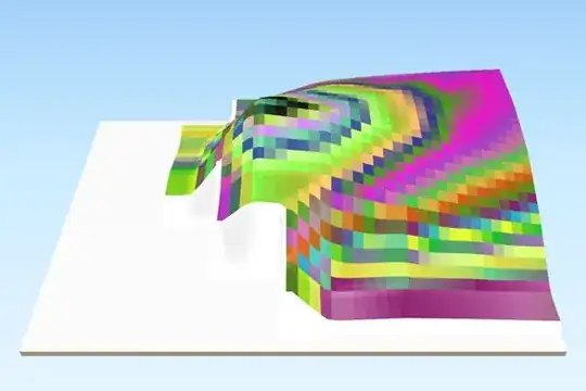

  1. Example of data enter image description here

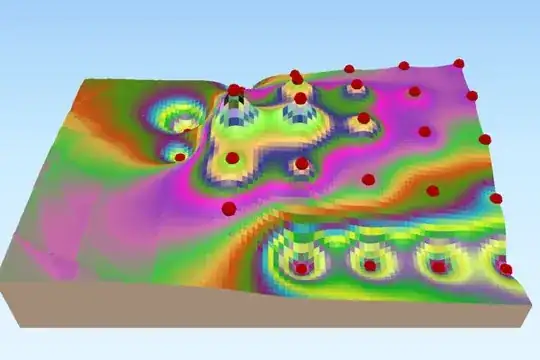

  2. gdal_fillnodata is incredibly fast but leaving spikes no matter how much smoothed, same with SAGA close gaps, where the speed is highly dependent on tension threshold, the bigger the faster enter image description here
  3. all (2 and nearest) gdal interpolations are not really suited for this task - nearest just takes the nearest value (not really interpolation), moving average is one step better but creates big steps not suitable for contours, the IDW is very hard to set to some reasonable results and anyway it takes too long enter image description here
  4. so far the best results I got are still with triangulation. Bus as I mentioned it takes long time with SAGA for middle size grids and for big it fails enter image description here

  • Miro, what is that visualization tool? That is really pretty output, I can see uses for that! – Michael Stimson Apr 23 '15 at 21:24
    @MichaelMiles-Stimson it is plugin for QGIS called Qgis2threejs - https://plugins.qgis.org/plugins/Qgis2threejs/ - it can export whatever you have in the map (raster/vector) to 3D visualization based on nice option of settings you can use - all as html/javascript/images witch you can view in any modern web browser. It is great tool, I really like it. There are only few things I miss there but might be added in the future :) – Miro Apr 24 '15 at 23:47
