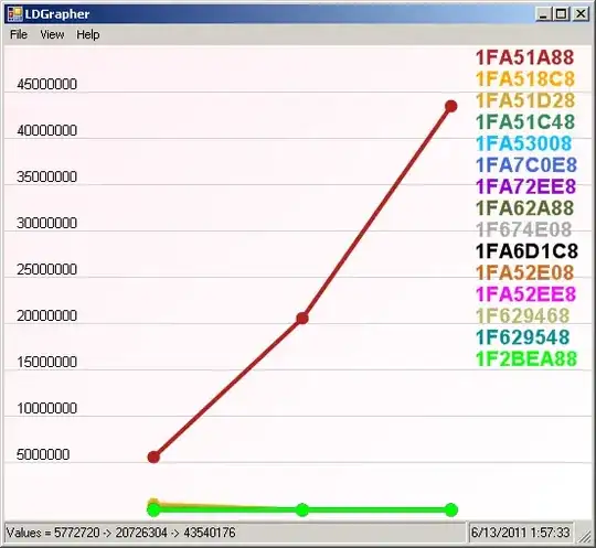

I then used LeakDiag and LDGrapher (with some guidance from this blog post) and logged the Windows Heap Allocator at three times: when I first load ArcMap and select the tool to initialize it, after running the tool a couple dozen times, and after running it a few more dozen times.
Here are the results as shown in LDGrapher's default view (total size): LDGrapher graph showing steady increase on memory usage
Here is the call stack for the red line: Call stack showing sg.dll call to SgsShapeFindRelation2 function
As you can see the SgsShapeFindRelation2 function in sg.dll appears to be what is responsible for the memory leak.
As I understand sg.dll is the core geometry library used by ArcObjects, and SgsShapeFindRelation2 is presumably where the spatial filter is being applied.
Before I do anything else, I just wanted to see if anyone else had run into this issue (or something similar) and what if anything they were able to do about it. Also what could be the reason for this occurring only with direct connect? Does this sound like a bug in ArcObjects, a configuration issue, or a programming problem?
