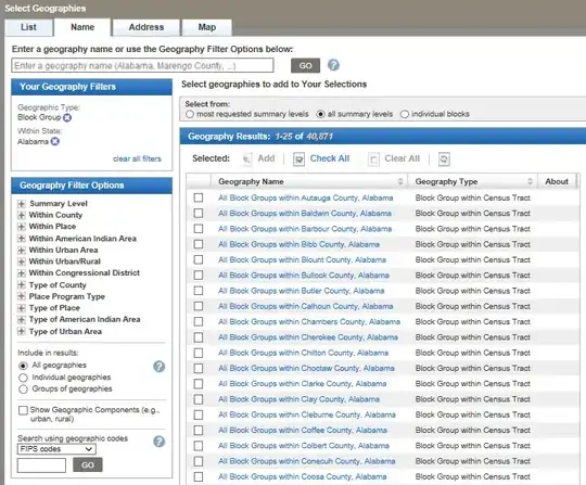

In the Select Geographies window that comes up, try the Name tab instead of the List tab. Adjust the geography filter options (e.g., "Block Group" within state "Alabama" in the image below) and it will provide you with a list of results.
Select all the "All Block Groups within Whatever County" geographies using the "Check All" box and it is much faster than selecting individual block groups one at a time through the List tab.

  • Yes, but my issue is if I am trying to select all of the block groups from the state of Texas, there are more counties than it will allow me to select.
    I am bothered that there isn't just simply an "All Block Groups within Texas" or something.
    I appreciate your reply though.
    – Rolando Martino Jul 17 '14 at 17:09
  • Unfortunately, there are limits put into place that cap how much data you can download through the AFF interface at once. Breaking Texas into two steps would be the only way around it. (For what little it is worth, Texas should be the only state that exceeds the 250 limit -- the next highest is Georgia with 159.) – Erica Jul 17 '14 at 17:12
