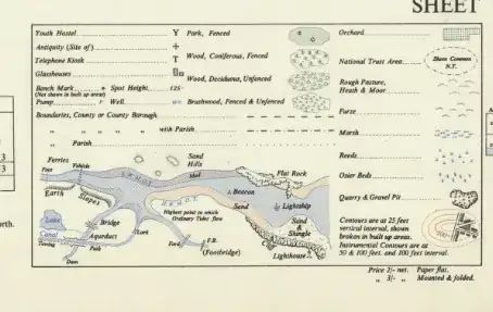

Correlate districts with other historical maps?
These maps aren't keyed to the 1939 Register specifically, but check the Ordnance Survey maps at the National Library of Scotland. In some of the series, there are maps from the late 1930s or early 1940s that show the district boundaries, like this 1:25,000 series map of Plymouth.
