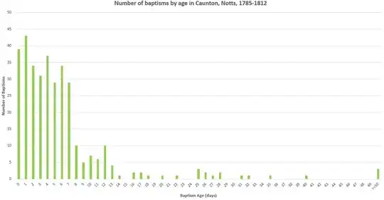

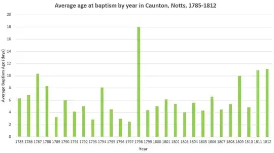

I decided to perform a little experiment with some data from the relatively small parish of Caunton, Nottinghamshire. The baptism register from 1785 to 1812 reliably recorded the date of birth. During this period there were 354 baptisms, of which 341 had a plausible birth date recorded (a small number were illegible or impossible [i.e. baptised before born]). I calculated the age at baptism and produced the following graphs using Microsoft Excel.

Looking at the average age at baptism by year indicates that in this parish there was not a great deal of change over this period in terms of the average baptism age in days. Note in 1798 the data is a little bit skewed because the sample size per year is quite small and there were two later baptisms that year.
Looking at the number of baptisms by age is also interesting. Over this period there were 39 baptisms on the day of birth, and similar numbers over each day in the first week after birth. Interestingly there is a significant drop off after the age of 7 days which suggests that some effort may have been made to baptise within the first week of life.
