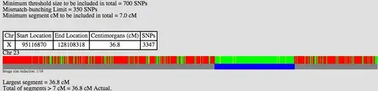

I recently uploaded one of the Autosomal DNA results I manage to GEDMatch.com and ran the X-Match routine and came up with a puzzling result.

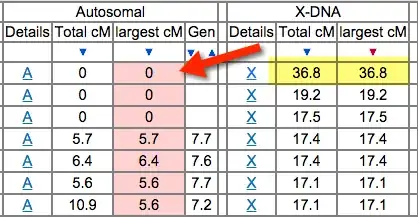

The strongest result by far on the test has 37.2 shared X cMs length (as pictured below) but GEDMatch is reporting 0.00 Autosomal shared cMs with the same individual. My understanding is your total cMs are the combination of Total X and Autosomal cMs even though not X-cMs are not included in the total in all sites.
Both kits being compared are Male, though the two others with 0cMs on Autosomal are female.
X-DNA Result Only from GEDmatch.com

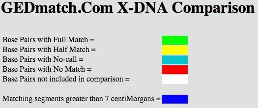

The key to reading the above graphic is here: enter image description here

I have also tried adjusting the minimum cM length all the way down to 4 and still nothing when doing a 1:1 with this kit on the Autosomal test. I have also looked at their "list" of matches and they have Autosomal matches with shared cMs but none on the kit I am comparing it to?

For a person who is related somewhat distantly (say, third cousin or farther), it is common to share only a single DNA segment (if any). The shared segment may be located on an autosome or, if the relationship is through relevant maternal connections, it may be located on the X chromosome.
Thus it is quite common to have results where there is a shared X chromosomal segment and no autosomal shared segments. This is just how the random passing of DNA through the generations happened to occur in the paths the DNA took between the common ancestor and the two related persons. It is much like the complementary case of having a single autosomal segment being shared (which would be on exactly one of the 22 separate autosomes) but not having a shared segment on the X chromosome.
Because of the expanding nature of each person's pedigree, most matches are distant and match on only a single segment on a single chromosome. If that chromosome is the X chromosome, you get what you highlighted in your question. If, alternatively, that chromosome is an autosomal chromosome, you get the most common case of a match, which shows some sharing in the autosomal column but no sharing in the X-DNA column. Both are perfectly normal results.
The only special consideration is that if you share an X segment from a common ancestor, then it can help you exclude parts of each of your pedigree trees from consideration as the possible source of the shared segment. Any part of the tree that runs through two successive males can be excluded since the X DNA cannot be passed through that connection. Thus if you are male, you can exclude half your tree (your paternal side) since the X segment did not pass that way. If you are female, then you still have to consider your father's maternal tree, but can exclude your father's paternal tree.
