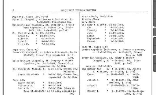

That disclaimer aside, let's look at what format Hinshaw's Encylopedia uses. Since Volume IV is not available to view at Hathi Trust, I chose a page from Volume I:
Hinshaw V1 sample
You can see that the name of the Monthly Meeting is in the header at the top of the page, and that some, but not all, of the data abstracted in the Encylopedia has a birthplace noted. My guess is that the people consulting Hinshaw have substituted the name of the Monthly Meeting for the birthplace because that is the only place information they have, in the same manner that someone researching in the UK might list the GRO Registration District that the birth was registered in as a placeholder, when they don't have the birth certificate in hand.
