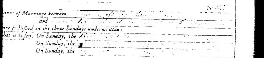

To give an example of how to use it, here is a crop from a parish record from north-west Kent.
rawimage =
ImageCrop[ImageCrop[ImageCrop[Import["~/Desktop/LoftWaldron.png"],
{1800}, Left], {Full, 750}, Top], {Full, 400}, Bottom]
I can make out that this recorded the marriage of John Loft and Sarah Waldron, but I can't quite make out her parish. There is no one right way to approach this, but here are a few commands to try. First, MinFilter spreads out dark regions to near neighbour pixels. This smears the printed text but darkens the handwritten text.

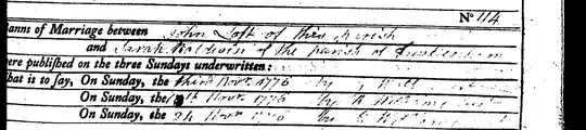

MinFilter[rawimage, 1]
Blurring the result using a GaussianFilter or similar surprisingly makes the image easier to read, and also helps fill in some areas where the ink is illegible.
GaussianFilter[MinFilter[rawimage, 1], 5]

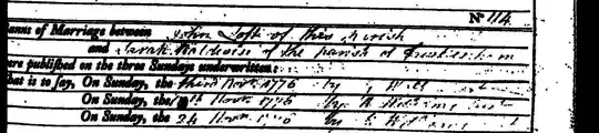

Sharpening again from here helps pick out details a bit better.
Sharpen[GaussianFilter[MinFilter[rawimage, 1], 5], 3]
Depending on the image, you may need to fiddle with the parameters. You can even use the Manipulate command to automatically make a sliders-and-buttons mini-app to play around with it.
And of course you can name intermediate results like this:
gaussianed = GaussianFilter[MinFilter[rawimage, 1], 5];
Sharpen[gaussianed, 3]
The particular image I've used here will never be completely legible, but one can now be more certain that the last four letters are nham. According to this list of Kent parishes, there are eight ending in that letter combination. Looking at the earlier letters, it could be Sydenham. The first letter looks more like an S than a T, but I can't completely rule out Twickenham in Middlesex.
