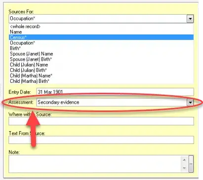

In Family Historian, the QUAY field is labeled as "Assessment". enter image description here
You can select one of 4 values for the assessment, and they are:
0 = Unreliable
1 = Questionable
2 = Secondary Evidence
3 = Primary Evidence
So you should give your so-called shaky sources a value of "questionable", and give your incorrect sources a value of "unreliable".
