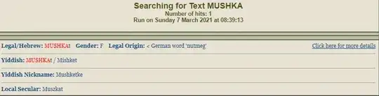

Oops, that makes my answer not helpful. Switching the context now to a female name, did you try jewishgen.org's Given Names Database ?
A preliminary search gives me enter image description here

  • Thanks, however, all the names you mention are male names and we are talking about the name of my grandmother mother... I strongly doubt that she was called by any of those names.... – epeleg Mar 07 '21 at 13:21
