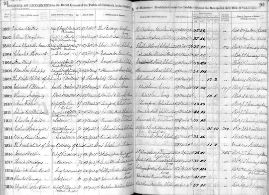

DeceasedOnline (a database of UK burials and cremations) shows that my ancestor Ellen Wright (née Brown) was buried in Cheshunt Cemetery Hertfordshire in 1871, in grave reference 37AQ.
In February and March 1917, the same database records that two further infant burials took place in the same grave; I haven't been able to discover a family link to either of them.
What does this reuse of the grave tell me?
Burial Register Ellen Brown

  • @ColeValleyGirl - having seen the pages, I suspect I understand what's going on. Maybe. I have editted my answer - see from "Looking at the pair of pages from the register" onwards. – AdrianB38 Jul 11 '13 at 16:37
  • Anyone wanting to actually read the pages needs to save the the image of the pages to their own PC - 100% magnification there is much bigger than the image of the pages above. – AdrianB38 Jul 11 '13 at 16:39
  • @AdrianB38 I can zoom in while viewing the image in my browser. –  Jul 11 '13 at 16:42

Looking at the pair of pages from the register, I believe that the explanation of what is probably (but not certainly) going on lies in the next to last column headed "If in Vault or Purchased Grave Space, No. of Grant". The 37AQ line in 1871 has no entry in that column. Therefore (setting aside the vault possibility, because @ColeValleyGirl says, from her visit, that it's a normal plot) the register indicates that this Grave Space (i.e. this plot) has not been purchased. So the council retained the right to use the plot again for another burial - which, in 1917, they exercised.
I have an inkling that in previous discussions in other places, I have seen suggestions that babies could be buried in convenient other graves. That seems to be the case here - they used a grave with room in it, to which they (the council) had the burial rights, and which had not been used for burial for 40-odd years. At least that way, the grieving parents were saved the expense of purchasing a plot.
In relation to my attempts just above to understand the legal situation with re-use - that situation does not apply, as re-use in that context must apply to grave plots where the right of burial is owned by someone other than the council concerned.

  • Having visited the cemetery, 37AQ (or where 37AQ should be if I had been able to find it conclusively) is just a normal-sized plot within an area of numerous marked graves (many with illegible markers). The page for the Register of Interments (now include din the question) that shows Ellen Wright being buried also shows 35AQ being used the day before and 36AQ being used a month later. The burial registers for the infants show that most burials at that time were happening in a different part of the cemetery, although 38AQ and 38AP was also used for child burials in Feb 1917. –  Jul 11 '13 at 09:31

  • I'd add the two other pages from the register but they would make the q too large. One baby is shown as 37AQ top end and one is shown as 37AQ bottom end. –  Jul 11 '13 at 13:00
