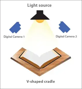

One way to do it is to use a DIY book scanner setup along the lines of the following picture:
The corresponding Wikipedia article has more information and links. There are also commercial kits available if you don't trust your engineering skills enough to create one yourself.
This set-up avoids problems with uneven light (you can set up and re-use a complex lighting system to equalise the light output at the pages), camera focusing (the distance from the cameras to the pages is near equal for subsequent pictures) and hand shake (the cameras are remote-controlled). It does however take some space and effort to create.

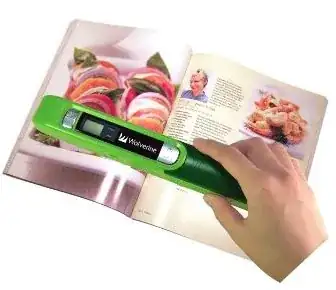

Personally, I'd use a camera.
But if this task is important enough for you, and you want really good resolution without damaging the photos, then for no more than $100 you can purchase a good portable hand scanner.
The particular one shown above is a PASS200 Handheld Portable Scanner. If you look around, you'll find it has a lot of competition and you can pick a model with the features you want.

    You might want to check if the scanner you're looking at will harm the pictures. – Luke_0 Jul 02 '13 at 22:46
  • @luke - From what I understand, a single scan is so insignificant in total light applied, that any effect would not be detectable. Photos fade only when exposed to light for long periods like hours or days. – lkessler Jul 03 '13 at 01:53
  • It depends on a lot of factors, but what you say is normally the case. The exceptions are enough to warrant some precautions, however. Old low-grade paper, for example, doesn't take much to get damaged, especially if it has been exposed to sunlight a lot over the years. – Luke_0 Jul 03 '13 at 02:00
    @luke - Still, it is always better to scan something once and use the scan for everything, while putting the original away in archival storage and never needing to access it again. – lkessler Jul 03 '13 at 03:21

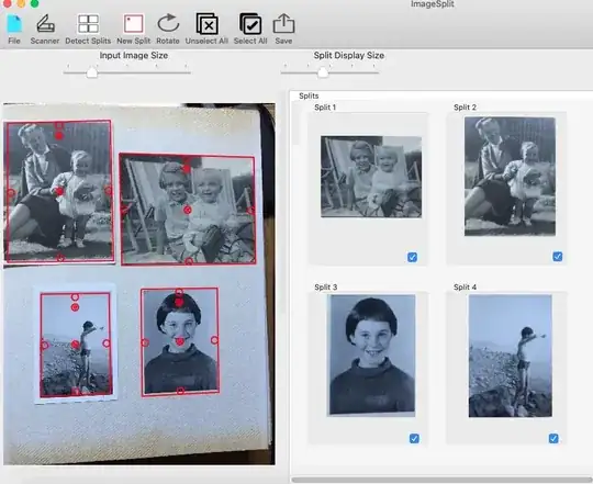

Digital cameras have become commonplace since this question was asked in 2013 and can provide images of large album pages which can be processed by various auto-splitting programs to yield individual digital images of each photo on the page. Using a camera allows processing of large pages and avoids any risk to the album by removing photos. Mobile phone cameras may not have a very high pixel resolution, which may limit viewing of extracted images to hand-held devices. Digital cameras generally have higher resolution and give better results.
Many programs for this purpose are reviewed at https://turbofuture.com/graphic-design-video/Whats-the-Best-Multiple-Photo-Scanning-Software. Different programs have widely different performance in automatic mode so it's worth testing a few. Many have the option of adding frames (or splits) manually but this is a slow process. Below is an image taken with a mobile phone camera, and automatically split using Caption Pro running on a Mac:Caption Pro for Mac .
