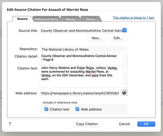

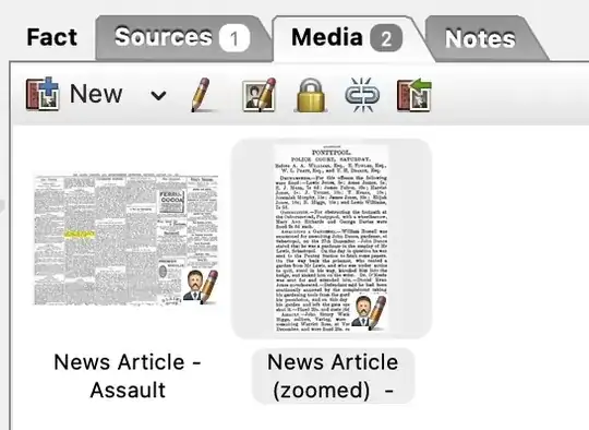

  • I have this fact:
Fact
  • I have this source citation:
Source
At the moment, the media is attached to the fact:
Media
How do you decide when to link the media to the fact or the source citation? And are there any side effects as a result of linking to source citation instead of fact?
