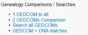

Yes, there is a site that will let you search trees of DNA testers whether they match you or not. The site is GEDmatch Genesis. They have a several tree searches available: enter image description here

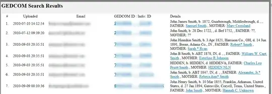

Here's a sample search for "John Smith": enter image description here

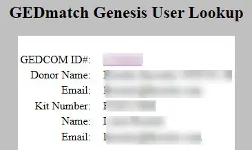

Then you can look up their GEDCOM ID# and find out their DNA kit number: enter image description here
That will allow you to check to see if their kit number is in your list of DNA matches.
