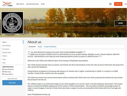

As far as Y-DNA and mtDNA for Mayflower descendants go, the only company that tests and gives Y and mt matches is Family Tree DNA. Family Tree DNA promotes group projects and one of the projects is a Mayflower project that is run by the Mayflower Society which currently has 1270 members. If you click on their "Project Statistics" page, you'll find statistics about the Haplogroups of the members, and you can find DNA details on the DNA Results and other pages.
