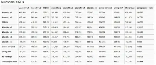

GEDmatch does not disclose its methodology for phasing at GEDmatch Genesis. But if you and your mother tested at different companies, especially different companies that use different chips, then it could be that GEDmatch Genesis only includes SNPs that it can phase that are in both sets of raw data.
ISOGG has an Autosomal SNP comparison chart which I'm reproducing here. enter image description here
You'll notice in the chart that 23andMe v5 tests 630,132 SNPs and FTDNA tests 698,179 SNPs. But the two chips only have 162,602 SNPs in common. No-calls on either side will also have to be excluded. Where there is only a parent SNP or only a child SNP and its allele values are the same, aka Homozygous (one of AA, CC, GG or TT) then the repeated value will be the phased value and the other reading isn't needed. GEDmatch Genesis could be doing all this and trying to get as many valid phased SNPs as possible.
Why chromosome 1 dropped to 0, I have no idea. Unfortunately, GEDmatch doesn't allow downloading of their Raw Data Files, so we can't see precisely what it created. Maybe you could run your kits and the phased kit through the GEDmatch Genesis DNA File Diagnostic Utility and see if comparing their summary data helps explain why your phased kit is different.
