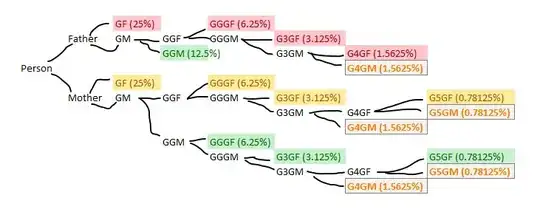

The other answers are correct with respect to the complications of ethnicity estimation.
But going back to your simple mathematics: If ethnicity was passed down exactly 50% from each parent and was measured perfectly, then any percentages are possible.
That's because:
  • Each parent would be 50%. You have 2 of them.
  • Each grandparent would be 25%. You have 4 of them.
  • Each great-grandparent would be 12.5%. You have 8 of them.
  • Each great-great-grandparent would be 6.25%. You have 16 of them.
  • Each g3-grandparent would be 3.125%. You have 32 of them.
  • Each g4-grandparent would be 1.5625%. You have 64 of them.
  • Each g5-grandparent would be 0.78125%. You have 128 of them.
  • Etc...
There could be pedigree collapse and some of your ancestors may represent more than one ancestor, but lets ignore that.
If you need to get to ethnicities of 36%, 35% and 23%, then:
  • The 36% could both have come from one grandparent (25%), one great-great-grandparent (6.25%), one g3 grandparent (3.125%) and one g4-grandparent (1.5625%). Total = 35.9375%
  • The 35% could both have come from one grandparent (25%), one great-great-grandparent (6.25%), one g3 grandparent (3.125%) and one g5-grandparent (0.78125%). Total = 35.15625%
  • The 23% could both have come from one great-grandparent (12.5%), one great-great-grandparent (6.25%), one g3 grandparent (3.125%) and one g5-grandparent (0.78125%). Total = 22.65625%
This can be drawn like this, with the colors highlighting the ancestors who were 100% from an ethnicity and passed it down. The percentages represent the amount the person received from them, assuming exactly half was obtained from each parent:
The red ancestors total 35.9375% (36%)
The green ancestors total 35.15625% (35%)
The yellow ancestors total 22.65625% (23%)
And the grey ancestors are the unspecified ethnicities and total 6.25% (6%)
