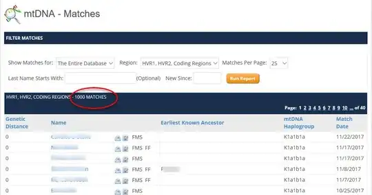

At Family Tree DNA, I did the mtFull Sequence test. I have 1,000 matches that include 284 exact matches at GD 0 for my haplogroup K1a1b1a which is a common haplogroup for Ashkenazi.

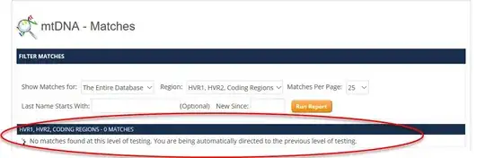

My Uncle (on my Dad's side) surprises me with 0 matches with his haplogroup H3w. Haplogroup H3w is also common for Ashkenazi.
Can anyone explain this discrepancy?
The only thing I know that may be different is that I initially did the mtFull sequence test. My uncle initially did the mtDNA Plus test and then upgraded to the mtFull sequence test. This shouldn't be the cause of this, should it?

I had some comments on this on the ISOGG Facebook group. Ann Turner, James Lick and Rebekah Canada set me straight:
My uncle has 4 mutations from mt haplogroup H3w and no matches that share one or more of those mutations without being different on others to give a Genetic Distance of 3 or less, which is what Family Tree DNA will display.
Whereas, I have 2 mutations from mt haplogroup K1a1b1a but there are a lot of people having the same 2 mutations without having any other, giving a Genetic Distance of 0.
So my uncle is connected to H3w but is on his own. Whereas I am connected to K1a1b1a with hundreds of other.
