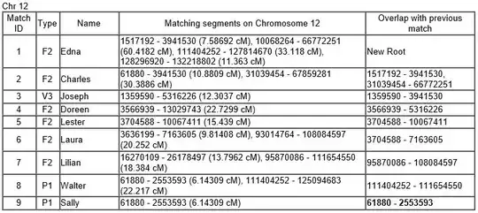

I ran a GEDmatch multi-kit analysis and got this report for Matches with Joseph's kit, for chromosome 12:
And putting a different kit in first position, I get this report for matches with Charlotte:
The strange thing I notice is on Chromosome 12, in the first report I get several matches that span as much as from 1,359,590 to 5,316,226 (about 12.3 cM). In the second report, I get Edna matching Charlotte from 1,517,192 to 3,941,530 (7.58692 cM).
The segment matches Charlotte from the first report, so why doesn't Edna appear in the first report? Is this a bug?

There are 46 chromosomes that come in 23 pairs, one from mother and one from father. You are talking here about chromosome pair 12.
The way matching works is that it cannot determine whether the match is occurring from the maternal chromosome or from the paternal chromosome. It only determines that either the maternal or paternal chromosome is matching at each point along the chromosome pair.
In your case, on that segment on chromosome pair 12 you have:
  • Joseph matches Laura
  • Joseph matches Charlotte
  • Charlotte matches Joseph (good, that verifies)
  • Charlotte matches Laura
  • Charlotte matches Edna (7.6 cM)
There are two possible reasons why Edna does not match Joseph.
  1. Charlotte matches Joseph on one of her chromosomes (maternal or paternal), and Charlotte matches Edna on the other.
  2. Charlotte and Edna match not because it is a common segment, but because it is a by-chance match where matching base pairs crisscross between the paternal and maternal chromosomes and appear to the matching algorithm to line up. The smaller the matching segment, the more likely this is to happen. Normally you need a 15 cM segment or longer before by-chance matches become improbable. At 7.6 cM, you always need to be suspicious that this might be a by-chance match.
Laura matches both Joseph and Charlotte so they triangulate meaning the 3 of them match each other on the same segment. Triangulation (without a by-chance match in there) is good assurance that they are matching on the same chromosome.
To verify whether Edna is matching on the other chromosome, or whether Edna's match with Charlotte is a by-chance match, you need other people to compare to. You will have to find at least one other person who matches Charlotte on that segment but does not match Joseph and Laura. Then on GEDmatch, you can do a one-to-one compare of that new person with Edna. If the new person matches Edna, then Charlotte, Edna and the new person all match on the same segment and triangulate. They will be matching on Charlotte's other parent's chromosome from the one she is matching with Joseph and Laura.
If the new person does not match Edna, then either Edna, or that new person, or both are a by-chance match with Charlotte and you'll need to find yet another person to compare with.
The key is to realize (1) there are two chromosomes in each pair that a person can match to, and (2) by-chance matches on small segments are possible. Knowing this allows you to logic through the possibilities.

  • This answer contradicts my current understanding of DNA, can you provide a source to cite your argument that in any given segment range, there are two sides to the segment and a match could be on one side or the other, and thus segment matching is not transitive? (Note: I do agree that for any given segment, it may consist of portions from your dad and other portions from your mom.) – WilliamKF Apr 13 '17 at 18:47
    @WilliamKF - Kitty Cooper describes it quite well here: http://blog.kittycooper.com/2014/10/when-is-a-dna-segment-match-a-real-match-ibd-or-ibs-or-ibc/ She gives an example of Dad giving her AAAAAAAAAAA and Mom giving her CCCCCCCCCCC and how she would appear to match to anyone with either A's or C's on that segment, e.g. ACACCAACCAC or CCAACCCACA. So using that example, people with AAAAAAAAAAA on that segment will match to each other on her dad's side, and people with CCCCCCCCCCC on that segment will match to each other on her mom's side. – lkessler Apr 14 '17 at 04:44
    @WilliamKF - Roberta Estes gives a similar example here: https://dna-explained.com/category/ibc-identical-by-chance/ and talks about an identical by chance match due to "zigzagging back and forth between your Mom's and Dad's DNA strands." – lkessler Apr 14 '17 at 04:53
    @lkessler Thanks, didn't realize the technology was doing an OR and thus allowing a match to hop back and forth between your mom and dad. Hopefully they will improve the sequencing in the future to map the two sides of a chromosome independently, which would make a match transitive. – WilliamKF Apr 15 '17 at 02:38
