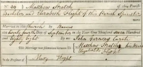

There is only one likely marriage record that I can find for Matthew and Elizabeth:
Marriage of Matthew Stratch and Elizabeth Flight, All Hallows London Wall, 24 Sep 1788
The marriage of Matthew Stratch, bachelor, and Elizabeth Flight, Spinster, both "of this Parish", at All Hallows London Wall on 24 Sep 1788. Matthew marked, Elizabeth signed.
There are no other obviously relevant "Stratch" records, so I do think this is a variant of, or typo for, "Stretch" (or perhaps Matthew's accent was unclear). The full name of William's aforementioned daughter was Elizabeth Flight Stretch - that middle name correlates nicely with this record (and has no other obvious explanation).

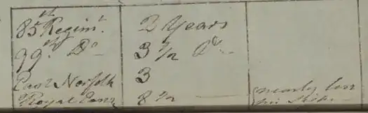

The discharge record has a hand-drawn table in the left margin, which appears to enumerate Matthew Stretch's service record: Matthew Stretch military record, from his discharge certificate
85th Regiment                       2 Years
99th Regiment                       3 1/2 Years
East Norfolk Regiment               3 Years
Royal East London Militia           8 1/2 years
(The lower line is hard to read, and continues into the fold, but it reads "Royal East" by comparison with the line above, and thus is presumed to be the Royal East London Regiment, where Matthew finally served. There appears to be a line drawn under the "8 1/2" suggesting a summation.)
This gives us a total service of about 17 years (give or take a bit, obviously) ending in 1805. On the second page of the discharge record it states 18 1/2 years service instead. That can't be accurately derived from the numbers in the table, but perhaps the table figures are rounded down to the nearest half year, while their sum without such rounding is 18.5. I'll use 17 years below as it's less constrictive, and I don’t think it changes the analysis significantly.

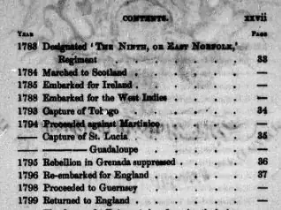

A book, "The Ninth, or the East Norfolk, Regiment of Foot", compiled by Richard Cannon and published in 1848, has a timeline for the regiment which includes this relevant section (from archive.org):
Timeline of 9th Regiment
1783 Designated "The Ninth, or East Norfolk" Regiment
1784 Marched to Scotland
1785 Embarked for Ireland
1788 Embarked for West Indies
1796 Re-embarked for England
If Matthew had joined the 9th shortly prior to 1788, he would have spent nearly another decade in the West Indies, which doesn't fit with his 3 years service. So he must have left before 1788. His three years fits flexibly between 1783 and 1788, and so he probably went to Scotland and/or Ireland during his service.
Summary: The likely service period in the 9th was ~1783/4/5-1786/7/8.

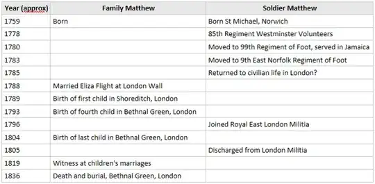

Well, if we go back to the "Family Matthew" Stretch who married Elizabeth Flight, there's a happy coincidence. Matthew and Elizabeth married in 1788 and had children from 1789 to 1804. The marriage and first few children fit perfectly within that 1785-1796 gap in military service. The Royal East London Militia would not have travelled far (an archived regiments.org page suggests <12 miles), so the continuation of their family during that period is plausible.
Now we can, tentatively, build up a parallel timeline for the two Matthews: Timelines for two Matthew Stretches There does not appear to be any clear conflict between the two timelines, so we can rule out neither the "One Matthew" nor the "Two Matthews" models. Typical. Baptism records for Family Matthew's children mention an occupation of "Porter" or "Painter" (and one I can't read) but none, alas, note him as a militiaman. "Painter" is one point of overlap between the records for the two Matthews (the other being approximate age). Although that was surely not an uncommon occupation, in combination with an uncommon name it looks more relevant.
So the military record does not show that Matthew the soldier was a different person to Matthew the father. Instead it provides a rather convenient fit to the family records. This isn't proof, of course, but it starts to look reasonable given the paucity of alternatives. I still don't have a birth/baptism record for Matthew - the only good match was born in the wrong Norwich parish and died in infancy. So there may be missing records or still some errors in the above work.
