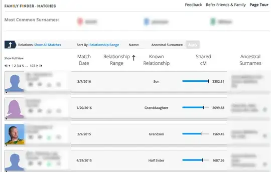

But a more practical example of a similar situation is my grandfather. You will see me and one of my 1st Cousins (not my sister) share significantly different number (500) of cMs with our known shared grandfather as well as we share more shared cMs with him than his known half-sister (they shared a father). So at 2000cms you are in this range.

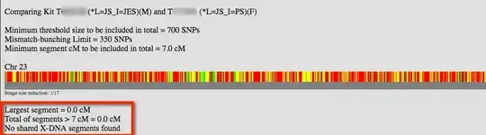

Why I say your mother's side is X-DNA is only passed down through the maternal line similar to mtDNA. This The Unruly X blog post on DNA explained is a good explanation with the key peice of information "because men don’t inherit any X from their father".
My grandfather and his half-sister share 0 X DNA (image generated on X-1:1 tool on GEDMATCH) as one would expect; because they share a father. enter image description here
