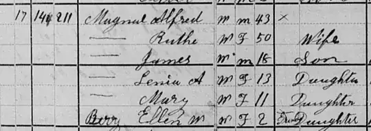

I'm looking at the 1880 census record for a Ellen M Berry. She stuck out to me as odd, being much younger than anyone else in the family, despite the transcription saying she was a daughter. She also has a different last name. I looked at the image of the record, and I see something written immediately before the word Daughter that clearly doesn't fit into the column it is supposed to indicate. I believe it says "Grand", as in "Granddaughter", but I'm just not good enough at reading such writing to get it perfect. What is the relationship?
I should add that I'm 90% positive that Alfred and Ruth married sometime in the 1870's, for a number of reasons. Previous census records indicate Alfred is married to a Mary, and there seems to be a mixture of the two. I have parents listed for each, that don't match, so I'm quite sure they are two different people. My theory is that Ellen is Ruth's granddaughter from a previous marriage, and I'm hoping this record can prove that. Alfred's oldest child was born in 1858, but she died in 1875, age 17, and no other child of Alfreds even makes sense.

    Concur that census says relationship is Granddaughter. Have you tried to find Ellen in other records, where her parents are named? That middle generation seems to be a key missing-link. – bgwiehle Mar 25 '16 at 19:32
  • Yes I have, with no luck, but I'm highly suspect of that actually being her name, based on the multitude of spelling errors that I already know of in the census record... – PearsonArtPhoto Mar 25 '16 at 19:34
  • Are you able to list all children of Alfred and Ruth that are not living with them for this census? These would be candidates for one of Ellen's parents. Where is this Census Record from? – PolyGeo Mar 25 '16 at 22:26
  • Ruth and Alfred were married only a few years before this census (Within 9 years), and had no children together that I am aware of. None of Alfred's children make sense to have been the mother of Ellen M, he had one older daughter, who died in 1875, and was single, so there's no reason to suspect she would be the mother. I'm quite sure it must be one of Ruth's children from a prior marriage. – PearsonArtPhoto Mar 28 '16 at 11:57

As noted in the question itself, FamilySearch's indexers missed the correction on the sheet and listed Ellen as a Daughter:
