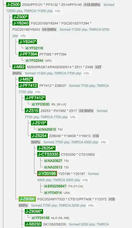

The very high level J-M172 simply means = J2 which is a little surprising they only were able to determine J2 from a Y-111 ... but you would get a much more in-depth result from further SNP testing on there (even more than 23andMe).
The 23andMe Haplogroup group is based on Y-SNPs (not Y-STR) and provided a little further detail with j2a1b1* = M92, M260/Page14; which is probably similar as you would receive through a National Geographic DNA 2.0 SNP test processed by FamilyTreeDNA.
Looking at the J2 tree on YFull it means you belong to one of the many branches under J-M92 which you will only be able to further determine through SNP testing like the Big-Y test or a SNP pack; I would recommend also looking at my answer to this question which I have some further detail on this.
Your High Level is J-M172 (J2)->J-M410->J-PF4610->J-L26->J-PF5087->J-PF5116->J-L558->J-M67->J-Z500->J-M92->One of the SNP sub-branches.
There are currently about two dozen defined sub-branches under J-M92 and as more people do Big-Y tests more are likely to be defined.
