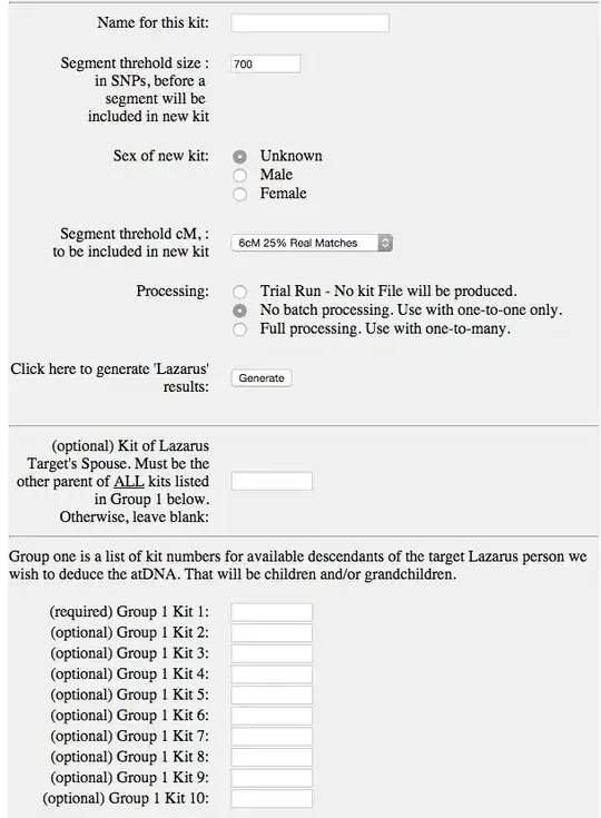

There is the Lazarus Tool on GEDMatch.com that is available to Tier 1 members of Gedmatch. Tier 1 means you have contributed at least $10 to GEDMATCH for the current period.
You can upload your families Ancestry.com/23andMe/FamilyTreeDNA results to GEDMATCH and then you can use the Lazarus tool to reconstruct a pseudo-kit for a untested / deceased individual to get a partial Autosomal DNA kit.
It can even be used beyond your parents but in theory a couple of generations away by capturing multiple descendants from different lines.. it will not of course be a complete kit but capture common elements from the included kits.
The minimum is at least 2 direct individuals that are in the children / grand-children range (referred to as Group 1) and contain up to 11 individuals kits and then further generations (group 2) is made up of more distant relations of siblings and cousins of the individual up to 100 kits.
The constructed pseudo-kit can then be utilized as a baseline comparison as a 'common ancestor'.

  • Excellent! I'd heard of the Lazarus tool but hadn't realized it could input the parent of the target's children. I'll look into the references you provide to see if there's a way to add in the target's siblings. (Perhaps I could generate a Lazarus L1 using the children, then use L1 and the target's siblings to generate an improved L2.) – Ellen Spertus Feb 13 '16 at 00:37
