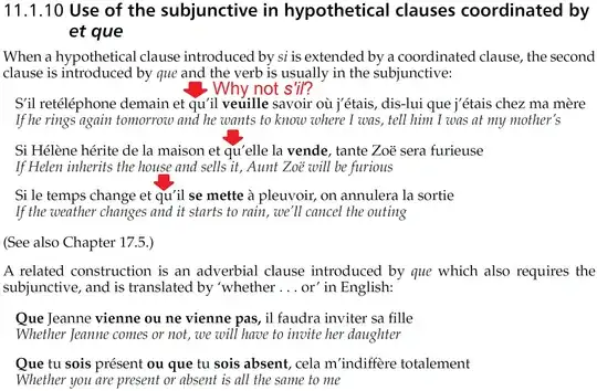

  1. que, its Latin etymons quod and quia, all never signified si or "if". Then why would que introduce the second clause?
  2. How ungrammatical, unidiomatic or heathen is it to write si where my red arrows below are pointing, rather than que/qu'?
enter image description here Roger Hawkins, French Grammar and Usage (2015 4 ed), p 272.

It can, but it is not mandatory. Both que and si can be used to coordinate conditional propositions and both are common and grammatical.
In the former case, que is just a generic conjunction used to avoid repeating si. Not using any conjunction might even be a better style as long as both clauses share the same subject.
There is no error of grammar in the choice being made, and at most a slight infringement on account of a not quite idiomatic turn, which, moreover, not everybody will notice or even reckon as real.
