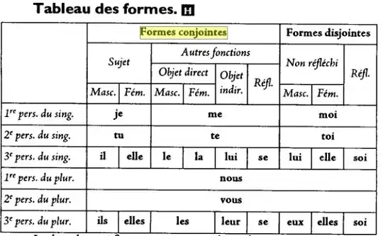

Your apprehension of this matter is correct. It is the subject of a subsection in LBU 14th edition (§ 672 c)).
Here is what can be read there. (Capital letter divisions, bold type and italics due to user LPH; "Elles" in the first sentence stand for "les formes conjointes objet indirect des pronoms".)
Elles tiennent lieu d'un déterminant possessif attaché au nom sujet ou complément. (Comp. § 352, b,à + compl. du nom). Il s'agit ordinairement d'un nom désignant une partie du corps (cf. § 609, a) :

         The pronouns (source: LBU)
Constructions on the model of "(A)" and "(B)" are standard; those in "(C)" border on the unacceptable and those in "(D)" are really not acceptable in standard French; those in that latter section, said to be current in "Le Midi" are only current among the less educated portion of the population.
In "(A)" the model of the first example is not standard French. For instance, "La main gauche lui tremblait.", on this very model is not said, normally; it is found rather in the talk of people with little education. Constructions on the model of the last sentence in "(D)" are acceptable but not elegant (Je m'enlève mes pantoufles.).
