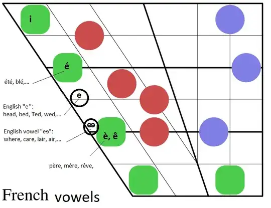

  • "é" could not be pronounced as the "ey" in "grey" but as the first component vowel of the diphthong "ei" , which one is the pronunciation of "ey" in "grey"; moreover, the French "é" is higher than this component vowel ; see the diagram. You could say that the French "é" is between /i:/, as in "weed" (but short) and /e/, as in "head", and somewhat closer to /e/. – LPH Feb 10 '19 at 13:07

  • @LukeSawczak Thanks for the details and the useful comparisons; surprisingly, they reveal that a strong h is pronounced in US "where", as in "who". They show also distinctly that US /e/ in bed tends towards French "è" whereas English /e/ is higher on the chart and should, I think, rightly, be represented by another symbol, such a symbol as in the Longman Pronunciation dictionary. – LPH Feb 10 '19 at 21:56
Complément de réponse ; comparaison de la prononciation des voyelles en français et en anglais selon la prononciation « RP » du Longman Pronunciation dictionary
