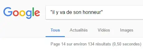

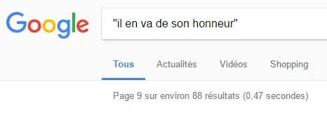

You are correct but that's nevertheless what the author meant in that sentence. Using en vs y is such a common usage that I didn't even notice the issue while answering on my phone.
If you compare il en va de son honneur vs il y va de son honneur with a search engine, you'll see it is often not spotted by newspaper's and other media proofreaders. I got 88 "il en va" vs 134 "il y va de son honneur".

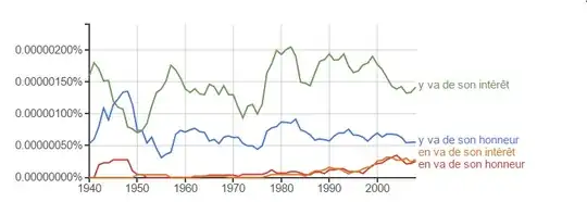

Even in books, the en va form usage is raising in the last decades.
