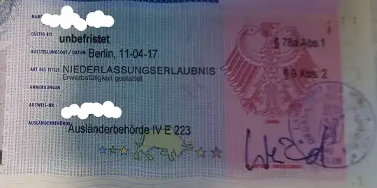

Note: in some places, such as in Berlin, it was not always possible to get a eAT. Even in 2017 adhesive labeled permanent residence permits were still being issued.
  • Canadian Passport issued in 2013
Even when the 5 year passport expired in 2018, no eAT was issued for the new passport (which during the covid period was for the holder very inconvenient).
Allthough the eAT was introduced in 2011, in Berlin they refused to replace the adhesive labeled permanent residence permits until February 2020.
My residence permit is an adhesive label. Can I get an eAT?
  • Adhesive labels for permanent residence permits issued before September 1, 2011 remain valid. This also applies to the residence permits that were issued from September 1st, 2011 as an adhesive label with the legal reference “§ 78a AufenthG”.
  • There is no legal right to prematurely exchange an adhesive label for an eAT. If a new residence permit needs to be issued (for example because a new passport has been issued), this will usually be issued as an eAT.
  • You can only apply for an eAT early in exceptional cases if you can demonstrate a legitimate interest (e.g. professional reasons) in the new issue.
  • The mere possibility that additional functionalities are available or can be used with an eAT is not enough.
Transfer / Reissue
  • If a new passport is issued or the name has changed (for example through marriage), the residence permit must be transferred, i.e. reissued. The transfer has always been carried out as eAT since February 3rd, 2020.
