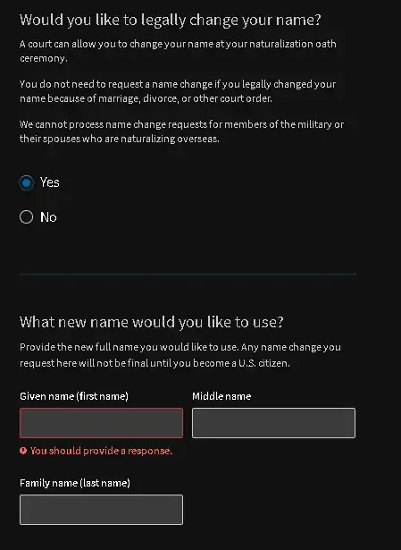

I have three first names, which are separated with commas in my French passport and spaces in my birth certificate. I'm considering only keeping my first first name on my future US passport. Does changing one's name increase the processing time of the N-400 (Application for Naturalization Form)? Processing time of the N-400 = from the N-400 submission date to the oath ceremony.
Changing one's name is an option in the N-400 form:

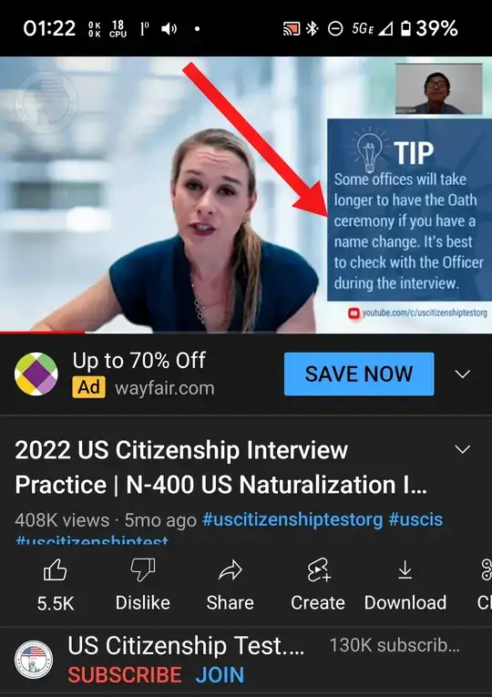

https://youtu.be/5QIu_gWfQ9A (4 min 30 seconds) claims that changing one's name may increase the time between the naturalization interview and the oath ceremony by up to a few months.
https://www.lawfully.com/resources/naturalization-processing-time:
If you are changing your name, it would possibly take you longer than an expected time. Since the federal courts or the USCIS can conduct ceremonies depending on a state, and only the federal court has an authority over a name change, this might be challenging if you live in a region where the USCIS conduct most of the oath ceremonies.
