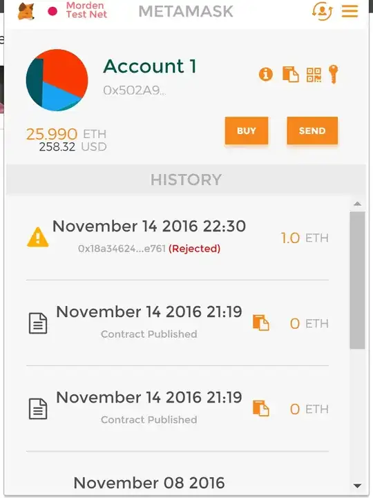

I'm sending 0.01 ether as part of transaction enter image description here
I can compile the contract but when I attempt to run the update function I receive 'VM Exception: invalid JUMP'
Have I omitted something with my contract ?
and using Javascript VM :
Have I missed a step ?
I'm using metamask and have ether in account :
