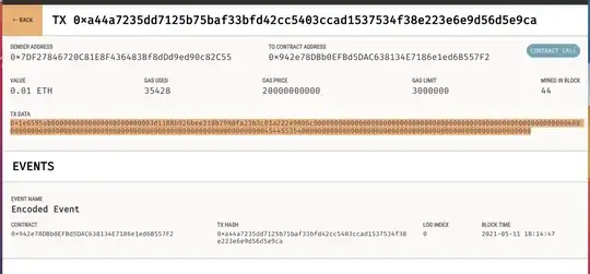

Turning TX DATA 0x1e6595ab0000000000000000000000003d1188b926bee218b7980fa23b3c01a222e9806c000000000000000000000000000000000000000000000000000000000000004000000000000000000000000000000000000000000000000000000000000000045445535400000000000000000000000000000000000000000000000000000000 to string the result is:
What are the characters before? And how do I make sure they are not stored in the blockchain? But with this it doesn't work because if you turn TX DATA 0x1e6595ab0000000000000000000000003d1188b926bee218b7980fa23b3c01a222e9806c000000000000000000000000000000000000000000000000000000000000004000000000000000000000000000000000000000000000000000000000000000045445535400000000000000000000000000000000000000000000000000000000
Ismael

  • It is not possible from a contract since ether transfers are "internal transactions", they don't have a visible txdata from block explorers. As said by Rob the usual solution is to generate events. If you really want the message to appear in a transaction's data field then you have use a non-contract account. – Ismael May 12 '21 at 04:41
  • I need to access the information later (i.e. access by address the transaction) and not at that time so it needs to be logged. The problem is that it gets logged but along with it come some strange characters and I don't know how to avoid that Shouldn't that be automatic when sending the transaction? – Lara Trindade May 12 '21 at 18:33
  • To interact with a contract you have to send the function id and parameters through txdata field. They are encoded using solidity ABI. It should be possible to send a text and use the fallback function for that case. – Ismael May 12 '21 at 20:00

  • But I need to store the information along with the transaction (in the TX DATA field) and not in a structure. The problem is that I get those characters before it that I don't know what the information is, and I just stored "info". – Lara Trindade May 11 '21 at 21:46
  • The first four bytes are the function signature. Basically hash("Transaction(address,bytes)"). It will be less trouble to ignore and store than to strip them out. – Rob Hitchens May 13 '21 at 15:20
