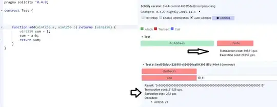

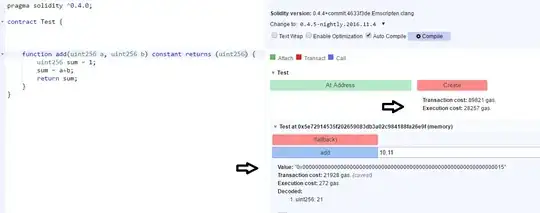

The computational work needed by a constant or non-constant function is the same when you create your contract or if you execute the function. The initial cost depends on the operations executed in the EVM, each opcode has its own price. You could check the list here (maybe outdated).
However, the "constant" keyword indicates that the function is not supposed to modify the states, and no gas will be used because it allows the function to be executed locally/off blockchain in your node.

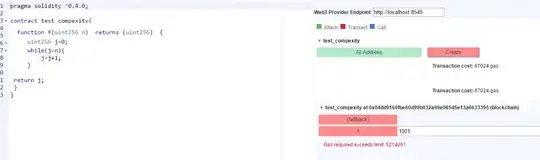

Test:
Edit: let's try to execute a loop within a constant function to get an idea of the computational work:
pragma solidity ^0.4.0;
contract test_compexity{
function f(uint256 n) constant returns (uint256) {
uint256 j=0;
while(j<n){
j=j+1;
return j;

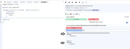

If we run this constant function with the input 1001, we get the result 0X
If we run the same function without the constant type and with the same input, we get an error: Gas required exceeds limit
So even if we are using a constant function, we are still under gasLimit limitation. Think of it as if you are using the constant function you are just paying yourself within a gasLimit.
