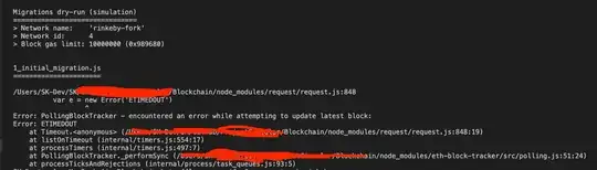

I am facing this error when on running truffle migrate on Rinkeby network with my infura

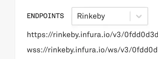

I found the fix by changing the infura Rinkeby RPC_URL in 'the truffle-config.js' file.
Originally I was using the https://rinkeby_url.
On using wss://rinkeby_url - it got fixed.
Please see a snapshot of the URL from infura. You can create a account on infura and generate these URL.

3Please fix the typo and provide the url you actually used, not the env var where you stored it... – DrGorilla.eth Aug 29 '21 at 20:02
need url not the env variable – Deepak Bhavsar Aug 31 '21 at 05:58
@DeepakBhavsar I have fixed one typo. And sorry I cannot display the complete URL, although I have added a cut snapshot for the same. You can easily generate your RPC URL from Infura. – Sahil Kharya Sep 06 '21 at 06:55
That just saved my life.. Thank you so much. @sahilkharya How did you find this solution? – AlonBA Mar 15 '22 at 16:27
@AlonBA - You are welcome. I was facing the issue and just tried different approaches, changing values and was able to fix it. – Sahil Kharya Mar 24 '22 at 02:12

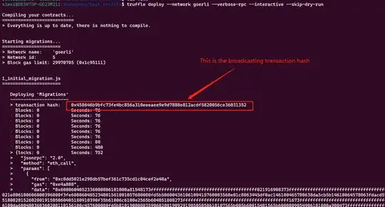

Step1. I ran this command to deploy:
truffle deploy --network goerli --verbose-rpc --interactive --skip-dry-run --reset
and it may give this error :
Error: PollingBlockTracker - encountered an error while attempting to update latest block:
undefined
at PollingBlockTracker._performSync (/mnt/d/workspace/test_truffle/node_modules/eth-block-tracker/src/polling.js:51:24)

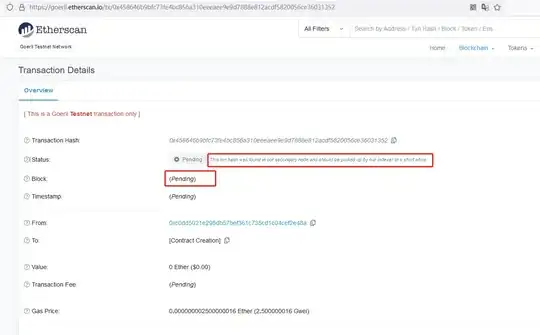

step2. run the command again, and you would get an output looks like:
copy this tx and view it on goerli.etherscan.io: you may found it's pending

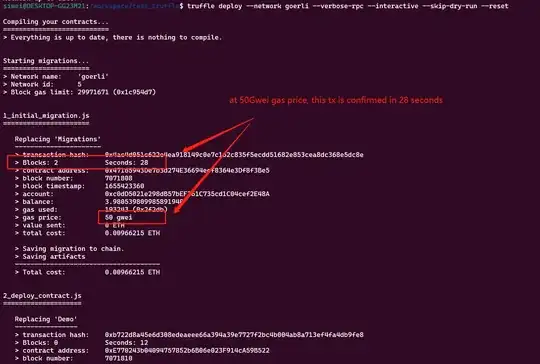

step3. let's increase the gas price from default to 50Gwei, then resend this rpc call:
// truffle-config.js
goerli: {
// you can also increase the gas price from default to 50 gwei, which is very high in 2022.6
gasPrice: 50000000000,
then re-execute the command:
then everything looks fine:

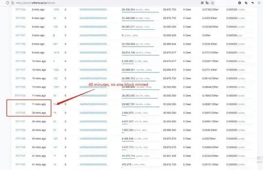

step4. finally , I checked the blockchain browser when I met "752 seconds timeout", I found at that time, all people's tx is pending ( another word, there's no one successful block minted during 40 minutes) . see the image below:
