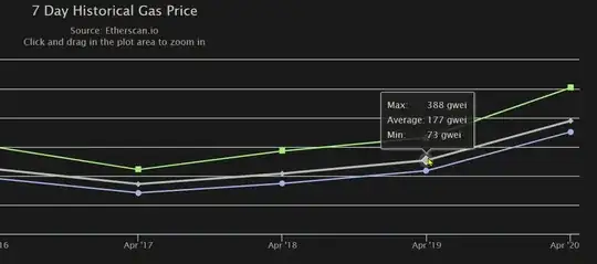

UPDATE: enter image description here
How we can see chart from the update yesterday (Apr 19) we have the minimum average gas price is 73 gwei. I create my transaction on Apr 18. I understand there was the moment when the average price was downing till 73 gwei.
Maybe I understand wrong, but if the gas price was less my price so the transaction must be included in a block already, otherwise I'm reading this chart and legend wrong. But my transaction is still pending at this moment...

  • I've updated the post. Do you want to say that miners can include transactions in blocks with a specific order and/or price and that I don't have to look at minimal average gas price? Yes, 73 gwei was yesterday but it was a specific deal. I'm confused about how it understand? – Mr. JE Apr 20 '21 at 00:38
  • @Mr.JE If the average is 177 gwei the 73 gwei minimum is not real. It is the result of miners including transactions with very low gas price, but they get paid off-chain or with a token transfer that aren't considered for the graph. I would say that with an average of 177 gwei a regular transaction with less than 150 gwei is unlikely to be mined. – Ismael Apr 20 '21 at 01:05
