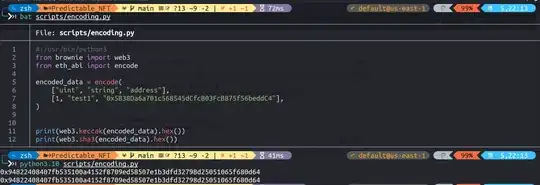

I found a way in Python to do this in case you are still looking for the answer. Here is the code below. Here is how you can do this in Python. I'm using the web3.keccak method of brownie which is similar to web3.py.
#!/usr/bin/python3
from brownie import web3
from eth_abi import encode
encoded_data = encode( ["uint", "string", "address"], [1, "test1", "0x5B38Da6a701c568545dCfcB03FcB875f56beddC4"], )
print(web3.keccak(encoded_data).hex()) print(web3.sha3(encoded_data).hex())
  • Here is the output
0x94822408407fb535100a4152f8709ed58507e1b3dfd32798d25051065f680d64
