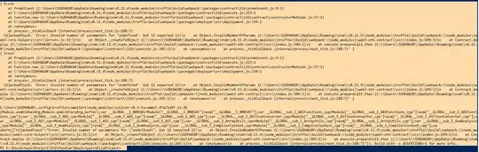

error after adding the await deployer.deploy( KiiACrowdSale, _rate, _ownerAddress, this.token.address,{chainId: 3} ); enter image description here

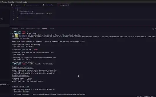

  • Change for "@truffle/hdwallet-provider": "^1.4.0"
  • npm install
  • truffle migrate --network matic
here it's ok
