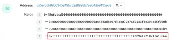

I'm having some trouble converting negative numbers in the log data of an Ethereum transaction. In this transaction, log index 192, topic 3 is listed as "0xffffffffffffffffffffffffffffffffffffffffffffffdb9a1221071741566a". Etherscan screenshot
Ethtx converts that hex value into a decimal of -671.4275583814931. Ethtx screenshot
I'm struggling to replicate the conversion of the hexadecimal value to a negative decimal value. So far:
  1. I can't find any functions in the Ethers.js and Web3.js libraries that convert to the right amount.
  2. Even just using an online tool, the hex value yields an output of 115792089237316195423570985008687907853269984665640564038786156449531636569706, which isn't correct.
Are there any libraries that would convert this hex value into the correct negative decimal?

The large number you got from the hex conversion is right. However, you have to account for integer overflow in solidity.
The original value in the transaction log is of type int256. If you cast 115792089237316195423570985008687907853269984665640564038786156449531636569706 into an int256 type you get -671427558381493070230. Then using 18 decimals the result is -671.427558381493070230.
In Python you can get an int256 with the following code:
large_number = 115792089237316195423570985008687907853269984665640564038786156449531636569706
size = 256 sign = 1 << size - 1
number_int256 = (large_number & sign-1) - (large_number & sign)
