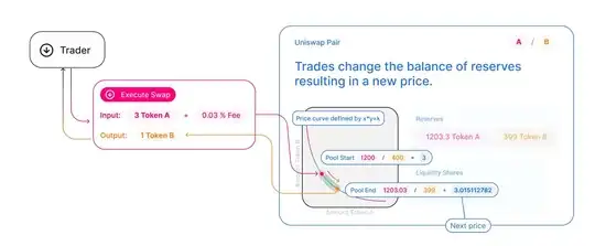

Moreover, the answer seems to suggest that the new reserves are rA' = rA + x * f and rB' = rB - P(x). I was rather confused when I have seen the diagram below from the documentation.
Here are my questions:
  1. If k actually increase at each trade, then why the price is computed in such a way (i.e. based on preservation of k) ?
  2. What should be the value of rA' on the diagram? Let x = 3, rA = 1200, then by the computation above, rA' = rA + x * f < 1203. It looks like that the illustration has multiple errors:
    • It says that the fee is 0.03%, but it should be 0.3%
    • It doesn't agree whether rA' is 1203.03 or 1203.3. But both are wrong either way.
  3. What the "price" in blue on the diagram actually means ? (why it doesn't use P(x) ?)
    The schema was definitely wrong and is now fixed. It still doesn't explain how calculations are made though, and contains misleading information. For instance, the 3% fee applies in the contract to the traded amount (amountIn), while the schema implies that the fee should be used to calculate the traded amount. Not a reliable source of info for someone who wants to dive in. – Jean-Baptiste Martin Dec 09 '22 at 16:01
