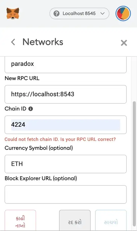

I want to connect local ethereum network to metamask , it says that it need chain id but when i entered the chain id for local node it shows the error "Could not fetch chain ID. Is your RPC URL correct?" I am running geth consol on local pc. What should i do ? thank you

  • geth --port 30303 --networkid 1234 --nodiscover --datadir=$ethereum_home/paradox --rpc --rpcport 8545 --rpccorsdomain "http://localhost:8000" --allow-insecure-unlock --ethstats paradox:s3cr3t@localhost:3000 --rpcapi "eth,net,web3,personal,miner" – Prasanna Desai Dec 17 '20 at 04:47
  • I tried --rpcorsdomain "*" and also tried to set network id and chain id same. But did not work – Prasanna Desai Dec 17 '20 at 08:19
  • You are starting that local node, and then trying to connect to it from MetaMask? And MetaMask gives you that error? – Franco Victorio Dec 17 '20 at 12:48
  • That is right , I started node and deployed contract on local ethereum , then I went to the front end of that contract to make a transaction and for that transaction to complete i need metamask. so I added custom RPC and it was long before the metamask update back then it worked very well but now it is asking for ChainId and when i am entering , it gives error. I tried both Hex and Decimal value of chainId – Prasanna Desai Dec 17 '20 at 16:17

You seem to have started geth with networkid 1234 and then are trying to reach it on id 4224.
Try connecting it to 1234 (or set networkid to 4224 in geth)
