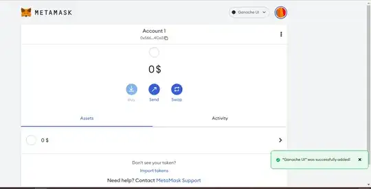

I think your Metamask already has a local network so delete that network first and then try it. it works for me. enter image description here
