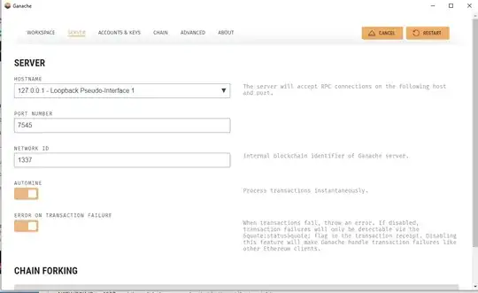

By Default ganache Chain ID: 1337 & Network ID: [veriable]
so, chenge your Network ID to same as Chain ID. for that Click on the settings icon at the top right of your Ganache Gui, then click on the server menu, change the NETWORK ID to 1337, and then click the save and restart button at the top right.
Changing Ganache NETWORK ID
