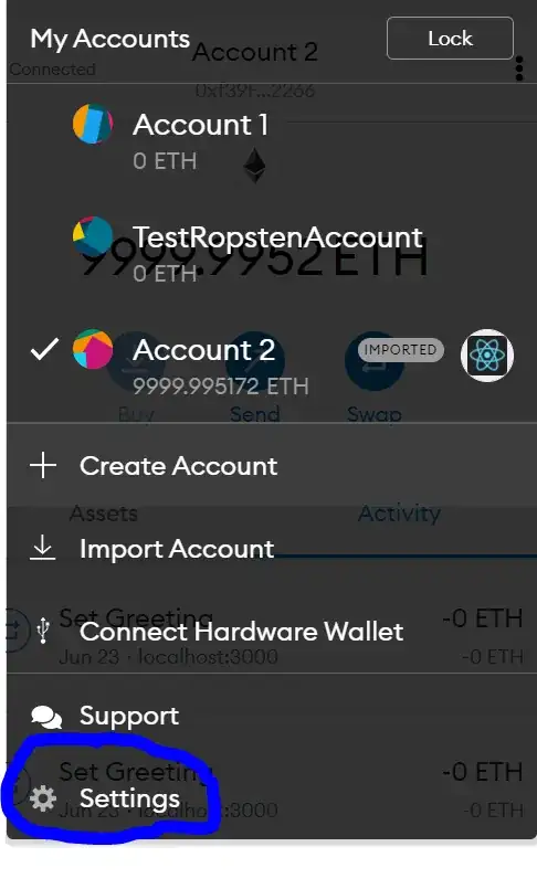

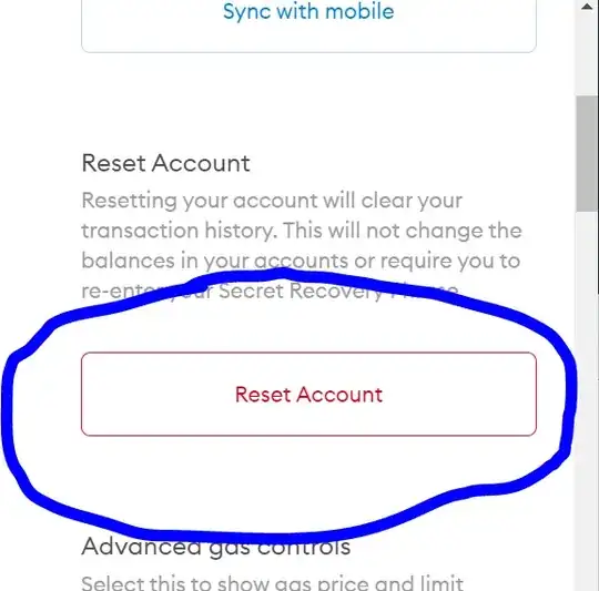

Maybe you could try to reset your account. In this case: MetaMask settings -> Advanced -> Reset Account.
aerialace
