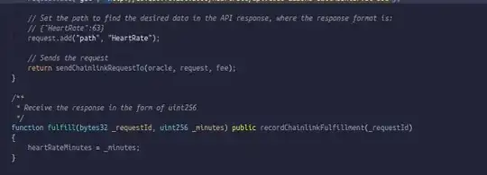

I am having a strange thing occuring on kovan network. I am running a smart contract calling my chainlink oracle to request some information. My chainlink oracle responds correctly with the expected information. The smart contract calls the fulfill function but it does not set the value heartRateMinutes. Any calls to it returns a 0. The expected value should be 67. Value is set to public so it should be seen. They also have the same size of uint256. The value is a whole integer number.
It is weird because the chainlink run job shows all green and no errors.
