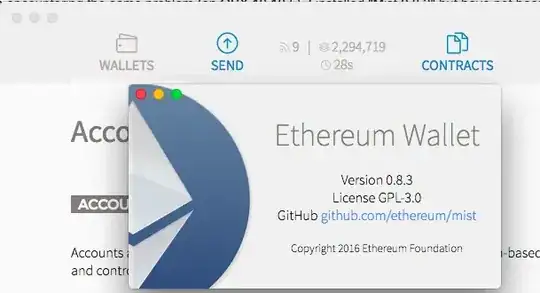

A new version of Ethereum Wallet 0.8.3 with geth 1.4.12 has been released at https://github.com/ethereum/mist/releases/tag/0.8.3, with the following message:
Security fix
This Mist & Wallet 0.8.3 release contains the updated 1.4.12 Geth version. If you were experiencing issues with Mist crashing after block 2283416, then that's the likely culprit.
Just install the new .dmg file and your old version show be overwritten.
This new version has synced past block #2283419:
geth v1.4.12 is packaged with the Ethereum Wallet:
