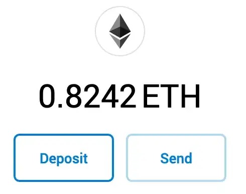

I want to display a human readable balance with less decimal places like metamask does it. The function formatEther(wei) returns a string, so for proper rounding I need to parse it etc. And I wanted to ask if there is an easier method or best practice how it's done.
