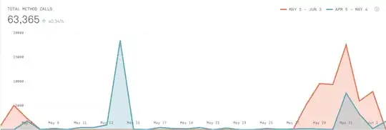

Looks like I'm being rate limited by Infura, despite making nowhere near the 100,000 request/day limit under Infura's Core plan. truffle migrate and truffle test both produce VM Exception while processing transaction: Error: Returned error: Returned error: project ID request rate exceeded. I even created a new Infura project and used that new project ID, but received the very same message. So, is it my fault? All I'm doing is ganache-cli --fork https://kovan.infura.io/v3/[api_key]@latest -u [address] followed by truffle test. What's the remedy?

I don't think the problem is that you are making too many queries but you are making them too fast. The daily rate gives be around 70 request per minute. – Ismael Jun 04 '20 at 16:30

Michael from Infura here, please email me at michael@infura.io and I will work this out with you. As Ismail said, it has to do with a short burst of requests, we are working with Truffle to best tune how it interacts with RPC calls during deploys.
