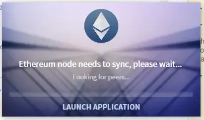

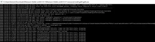

I have been trying to get my Mist application to sync to the Ethereum network. I tried running geth directly also, screen shots below.
Blockchain not syncing
geth
Mist

Are you downloading (syncing with) the block chain for the first time? If so, it will take some time due to the size of the block chain.
Just to make sure there is no connectivity related issue you can use wireshark and check whether peer discovery is working (packets are exchanged between your machine and the default geth bootstrap nodes:

    This is not the first time syncing to the blockchain. Appreicate the code snippet. I will have a look in wireshark.
    – Lismore Aug 10 '16 at 20:57
  • Make sure you are using the same data directory otherwise geth will re synchronize. – Sebi Aug 10 '16 at 21:05
Finally found a solution
geth.exe removedb
which cleared the chain and then
geth.exe --fast --cache=2048
to resync
