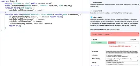

Update I've got connected by rpc, however on the browser-solidity I cannot connect my private node.

  • I've got data from node. Thx! However, at the browser-solidity, I cannot connect the local private node. Could you figure out what is the reason? – Toshi Aug 06 '16 at 03:47
  • Please ask a new questions and I'll look into it. – BokkyPooBah Aug 06 '16 at 03:50
    I've questioned! Plz check it:) http://ethereum.stackexchange.com/questions/7796/invalid-json-rpc-response – Toshi Aug 06 '16 at 04:00
